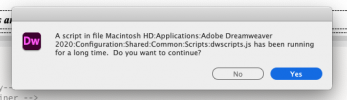

Trying to use this extension... everything hangs, and I get an error. See screenshot. When i uninstall the mysqli extension, the problem goes away. I am on a mac.
That is an Adobe file that helps with Server Behaviors. It is probably an issue on the particular page you are working on and the syntax of the code causing issues for some reason. If you send me the page I can try to reproduce it and find a fix for you.
I didn't get the email...Please attach to a reply here.
Note the delay is only present when using a site defined with a web assist page in the site. Other sites do not have a delay.
This stalls because of the hand coding you did in the Insert server behavior code.
It is trying to get the data from the insert to populate the Server Behaviors panel and runs into problems when it gets to your hand code.
The best solution when hand coding is to make sure you break the inspection early in the code. So for instance add a comment after line 10 like:
// hand coded insert
Adding that line would prevent Dreamweaver from trying to interpret the server behavior and prevent the crash.
(You can probably open the page with notepad to add the line at this point)
