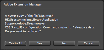

arrow downCommon Alerts
During the installation process, there are three alerts that may appear:
  1. The same version of a file exists
  2. A newer copy of a file exists
  3. An older version of a file exists
When any of these alerts display, you can choose Yes to All to proceed with the installation. This should not cause any problems.
