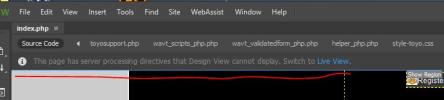

In Dreamweaver when I open a page and try to view the tables i still do not get them but we see different results. When opening a page I get a message stating to dynamical discover the page. Which I do then I get an pop up stating My certificate doesn't match (see pic)
I choose yes to proceed then get a new message ...
"This page has server processing directives the design view cannot display/ Switch to Live view" (see pic)
When I choose live view I get a similar screen to Design view.
