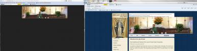

The tip you gave above did work well in the preview mode, but when I added it to a page I received the following error, and a stretched version of the gallery:
Warning: opendir(/homepages/40/d369590415/htdocs/ourladyofgrace/WA_Globals/galleries/slideshow_wide/css/themes) [function.opendir]: failed to open dir: No such file or directory in /homepages/40/d369590415/htdocs/ourladyofgrace/gallery/admin_gallery/common/functions.php on line 490
I am also attaching an image of the preview mode and what I see on the page (I had to revert to previous page so live site would look ok).
