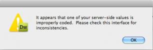

OK that worked for the editor once i renamed the folder but now if i add my style sheet into the contents_update.php file and don't save as a preset the codiing changes from:
// WebAssist iRite: Rich Text Editor for Dreamweaver
$WARichTextEditor_1 = CreateRichTextEditor ("ContentValue", "../HTMLEditor/", "713px", "400px", "Custom", "../custom/contents_update_ContentValue1.js", "".($totalRows_HistoryUpdate > 0)?$row_HistoryUpdate['HistoryValue']:$row_WADAContents['ContentValue'] ."");
to
$WARichTextEditor_1 = CreateRichTextEditor ("ContentValue", "../HTMLEditor/", "713px", "400px", "Custom", "../custom/contents_update_ContentValue1.js", "\".($totalRows_HistoryUpdate > 0)?$row_HistoryUpdate['HistoryValue']:$row_WADAContents['ContentValue'] .\"");
and stops it from working i can edit the two \ out so it works but my stylesheet is not added if i save as a preset then when i go to edit the text i had in a page it has gone and again my style sheet has not been added.
Also the following error now occurs (see attached)
