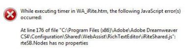

At an error in iRiteShared.js: rteSB.Nodes has no properties...See attached file
I have cleaned the configuraton cache and deleted the winfiledat file uninstalled and reinstalled and still to no avail.

Thanks for info about the steps you have taken and the screen shot. What is the version of iRite that you have currently installed? There was a recent release of v1.0.3, is this the release you have installed? If not please go to your download area and get the latest version. If it is I can open a ticket for you to get this further checked out.

We were able to determine the issue was caused by applying the page to an html page instead of a page that has a server language. I will log this as a bug, since it should alert the user rather than throw a javascript error.
