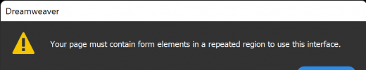

He is an example that show the issue. Even when the <option></option> element has a loop multiple update records do not recognize repeated region.
Multiple update is usually to update multiple records with multiple form fields. You may be using the wrong interface. I need to understand what you are trying to do by seeing the page in context. Maybe a normal update server behavior is what you need.
