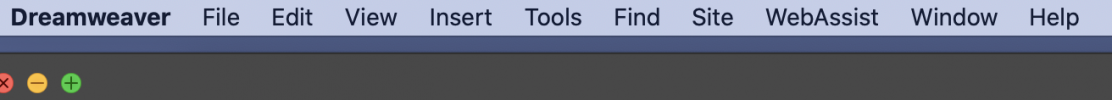

I get this pop-up notice whenever I try to insert captcha via the "Webassist/Forms/Insert Captcha" menu item - - no matter what page I open. (See the first attachment) When I use DMX Zone Extension Manager to uninstall Databridge, the webassist menu item does not go away (see the second attachment).
I'm using Dreamweaver CC 2020 [lifetime license] on a Mac running macOS v10.15.7
