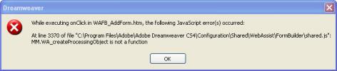

Getting error when finishing form builder
Thread begun 9/17/2009 10:08 am by chris384639 | Last modified 9/17/2009 3:26 pm by Jason Byrnes | 1667 views | 1 replies |
chris384639
I'm getting this error when I am finished editing the form and click FINISH.
Suggestions?
Did you perhaps install an older extesnion after installing form builder?
Try removing form Builder From the extesnion manager, then reinstalling it.
after reinstalling, delete the Dreamweaver cache file from the users configuration folder:
