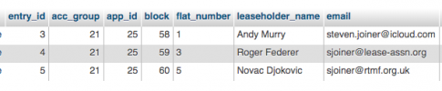

I have also attached two screenshots of the database tables that are being queried, as follows
1 - registered_apps
2 - consented_leaseholders
