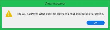

When I go to the message page and click on Sever Behaviors I get a series of error messages beginning with this one attached. Once I click through the rest of them there are no server behaviors displayed.
I used Universal Email for years and it worked great. It's supposed to be in the Data Bridge package, but it is not in the WebAssist list.
