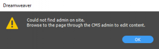

I moved a site from one server to localhost on a new server. DB has been successfully set up on the new server but I'm unable to connect to Power CMS. I get the following error. I must be overlooking a file to update to localhost or to reset the admin credentials. When I select the editable region in DW, I get the option to "edit in Power CMS", but when I click on the button, I get the error shown in the attachment. Can you point me in the right direction?

It looks like this server is running php7. PowerCMS has not been updated for php7 yet. You will have to change the php version to php6 or below in order to run powerCMS on this site.

I understand. The simple change in PHP versions took care of the issue. Thanks so much for the help.
