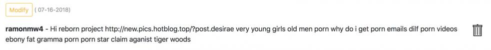

You can see from the attachment that reCaptcha was fully bypassed in sending this spam from one of our forms.
My latest attempt added a $_SESSION value on the sites home page and only submit the email sending and form submission IF the Session was present. But this causes issues if a linked page is used to enter the site and then the Contact form is used. And it does not work as the attached successful email / form submission was from a contact page that should have been secured by the session check.
Current screens on the email that went through are to make sure it's a page POST and the home page Session is present.
Next screen if the from email is fro, and address that ends in @mail.ru <- this actually works
Lastly the HoneyPot is that our comments field is not the actual comments field and if there is a value present do not allow passage.

I've gotten to the point of only allowing the email aspect to send if the SelectList choice is #1 since their pattern of posts targets selections value >1
Yet as seen in the attached screen today we received another post (but it was not emailed to the Customer or myself) which also allows us to confirm the page being targetted.
