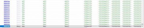

I can't get the db populated from the checkout any longer.. I am getting NULLs and slashes on the 'Orders' table and on the Orderdetails' table.. See attached. What did I mess up? it was working a few days ago. Thank you.
I'd have to debug it.
Do you have a url where I can reproduce the problem and can you give me FTP access? I'll take a look.

looks like I got it fixed by copying code from another website. I'll contact you if any further issues. Thanks.
