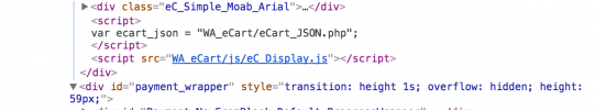

I'm having a heck of a time trying to custom style some elements generated through eCart. See the screen caps attached for the checkout page. How do I select that "Change Address" button? Inspector only shows JSON link and I can't figure out from that file what the selector should be. Also, the payment_wrapper sets a fixed height of 59px inline (seems a bad way to do this). I need to increase that height to account for the height of my standard button stylings. How do I do that?

The height is calculated through javascript based on the height when the page opens and set through the script. This is so the transition effect can take place when it is collapsed.

Yeah, I figured out the height situation was automatic. I was checking with browser width with break points and thats where I was seeing the clipping if I wouldn't reload the page. Height still seems to be setting too tall, but I'm going nuts trying to get a layout set for 790 pixels wide to go to the full width of my layout.

Deleting and stripping tags is risky business because the javascript is depends on it. You can find the code on the paymentoptions.js file.
For determining the height it just finds the "Shipping" and "Billing" fieldsets and then finds the parent node and tries to determine its natural height.
