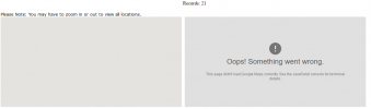

After quit some time of Google Maps working I have suddenly gotten a message that says, "Opps, Something went wrong." As seen in the attached photo. Do API keys expire or something?
API keys shouldn't even be necessary any more. Try removing it. If you haven't already, update your maps to version 3. If this is a really old implementation it might need to be redone with the latest code base.

You were right. I simply removed the API string after the "key=" and it came back. Not going to try and reinvent the wheel here. If it works I'm good and it works. Thanks ;)

I have the same problem however when I deleted the api key it still doesn't work. What should the line of code look like without the key, maybe I deleted it wrong?
Google has changed their policy for this.
You will need to specify an API key and you will have to go into your google account and make sure that the API for Maps as well as the API for Geolocation are enabled for that key.
