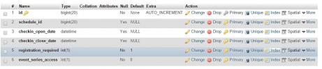

I'm trying to get my insert to insert NULL or and empty string when the $_POST["checkin_open_date"]." ".$_POST["checkin_open_time"] or $_POST["checkin_close_date"]." ".$_POST["checkin_close_time"] is left blank on the form. I've tried WA_BLANK and WA_NULL, but niether of them seem to be working. Any idea what I'm doing wrong here? I'm attaching a screenshot of the table structure so you can see that the default value for the columns is set to default to NULL. I've also tried WA_DEFAULT, but no luck there either. The only thing I can think of is it's the concatenating, but I didn't know if that would matter.

It's been inserting the current date and time, 1970, or all zero's depending on what I've tried. The current code inserts the current date and time.
