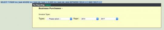

For instance, this query:
SELECT * FROM inv_task WHERE inv_task.tsk_type = 4 AND inv_task.tsk_date BETWEEN '2014-1-1' AND '2017-1-1'
Fails on a web page but works in PHPmyAdmin
$Records = new WA_MySQLi_RS("Records",$Domains_i,0);
$Records->setQuery("SELECT * FROM inv_task WHERE inv_task.tsk_type = ? AND inv_task.tsk_date BETWEEN '?' AND '?'");
$Records->bindParam("i", "".$_POST['selinvoiceType'] ."", "4"); //target
$Records->bindParam("i", "".$_POST['selYear'] ."", "2015-1-1"); //targetYear
$Records->bindParam("i", "".$_POST['selYear2'] ."", "2016-1-1"); //targetYear2
$Records->execute();
