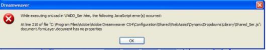

- See the attached screen shot.

- Brought up site/web page in CS4 that I want to use the extension on - when trying to Select "WA Dynamic Dropdowns / Create Dynamic Array" the registration box pops up with the error and does not alllow me to continue - see previous posting for a screen shot of the error message...

Could you post back with the line of code that the error message is referring to?
donald.l.moore379153
Line Number
Its line # 210 thats causing the error - refer to attached snapshot of the error that pops up.
Thanks!
Jimmy Wu
What I was looking for was the actual line of code from that file, just to verify that its not a different on your file.
