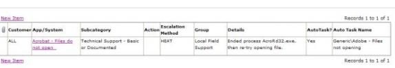

I am tasked with building an intranet support matrix, for quick relevant troubleshooting steps for our helpdesk to view and assist in entry level troubleshooting before escalation.
the directory is named "supportgrid"
The index page, consist of a simple table, that echos the form data in an easy to read manner and is ordered by application/system. (See screenshot below.)
when adding a new system, I have a form for creating new entries named addnew.php
This op-test perfect, and works as expected.
