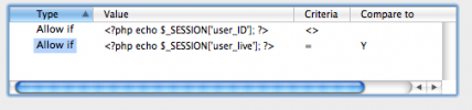

and on my protected page I've tried editing the Rules (as per the screen grab) to try and check if the 'live' column is set to Y or not...
I know this is glaringly wrong somewhere... can you set me straight please, many thanks as always

Thanks for your help - this seems to log me in regardless...
Here's my Login script, and my page security is attached

For the first rule You have the crittirea set to "<>" (Not equals"
change it to "="
from my initkal reply:
  change the first rule from
Allow if SESSION['user_ID'] <> (blank value)
to:
Restrict if SESSION['user_ID'] = (blank value)
note that I suggest 2 changes:
1) Change Allow if to Restrict If
2) Change the criteria from "<>" to "="

Sorry - not paying attention !
That's great thanks very much
