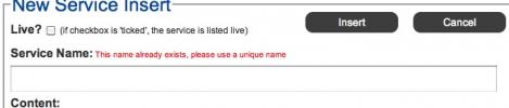

1. in the backend, I have set up validation show ifs for the relevant field on both the _insert and _update pages. They work fine unless you make an attempt, get the validation error text and then hit cancel. If you then go back into the page, the valideation error text is already there....

1) The validation failure is stored in a session. the session is cleared when the when validation passes. if you select the validation server behavior and go to code view, it will have the validation code block highlighted, about the 3rd line is the line that sets the failure session, it will look similar to:
$_SESSION['WAVT_index_Errors'] = "";
in this example, the validation is being applied to a page named index.php. you could add the following at the bottom of the page to clear the session:
<?php if(isset($_SESSION['WAVT_index_Errors'])) unset($_SESSION['WAVT_index_Errors']); ?>

Have been adding the server validations and they all work absolutely fine until I clear the session.
Basically, what is happening (if I dont clear the session) is that when the title is duplicated the warning/error message appears but if you cancel the page and come back to it that message still shows.
When I add the clear session
servicescontentsinsert_622
it still goes to validate but and stays on the page but the message is not visible at all when it should be....
