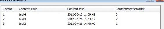

I seem to have hit a bit of a wall in that the date that is being returned from the database is showing the most recent date for all 3 posts rather than the date that each one should have.
As you can see from the attached image (dates.jpg) there are 3 different dates in the database for the 3 different posts.
But in the screen shot of the list on the front end, although the titles are listed fine, the dates are only showing the date from the most recent post.
I have spent ages trying to trouble shoot this and fix this but am really struggling... I just dont know what I should be looking for to effect a fix and would really appreciate a steer.

Hi, wouldnt that attached image suggest you have your repeat region code slightly off on your page? since its not moving the repeat counter for the date part of your code. have you exmained the repeat region area on your page? perhaps its just the slightly line placement thats causing your issue?
