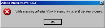

I installed HTML Editor and immediately received some error messages.
I am attaching an image of these. I wonder what I need to do to install this extension.
Many thanks
John
john70964
I restarted the computer and now seem to get a WA Memento error quite a lot before and when opened in DW
I have attached the error image
john70964
I found that by deleting the wincache file I have now removed the Memento error message.
john70964
After this using cssFormbuilder created more errors.
I deleted this extension and reinstalled it, deleted the wincache file and now everything is back to normal,
except in webassist > Forms > I can see HTML Editor even though it does not appear in Commands extension list.

if you are using CSS Form Builder 2.0.1 and HTML Editor 3, make sure that you install CSS Form Builder before installing HTML Editor, installing HTML Editor first will cause errors similar to what you are describing.
