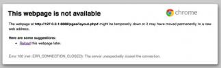

Hi guys, as soon as I add the Secure Page extension to a page it will no longer load if not logged in. If you log in first and go to it it works fine, but it seems it won't redirect at all if not logged in.

No errors come up when using that php error code .. but here is the zip file of the page for you. There is nothing unusual about the page at all.
your page is using the virtual() function for including files:
<?php virtual( "/pges/webassist/security_assist/helper_php.php" ); ?>
instead of require once. this will happen if you set the "Create Links Relative To" option in the Dreamweaver site definition to "Site", using "Document" will cause Dreamweaver to use the require_once function.
There are a couple problems with using the virtual function:
1) The virtual function is only avail;able on apache servers.
2) When the virtual function is used, it writes a bit to the document header which generates the Headers Already Sent error on trying to redirect.
I recommend setting the "Create Links Relative To" option Document so that includes will use the require_once() function to prevent these issuers
