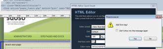

I have occurring the strangest thing. I am working in Data Assist pages intending to add HTML editor to some text areas.
1) I select the textarea, then click the HTML Editor icon.
2) the HTML editor opens and I can clearly see that the right text area is selected.
3) I click to edit the editor (any button) and I notice that the Content Wrapper Div is suddenly selected (see picture attached).
4) if I carry on and insert the editor to the page, it then asks "add a form tag?" (see pic 02).
If I continue to add it to the page ignoring the "add a form tag", it inserts the editor but blows out all other form elements on the page and replaces it with the html editor.
What on earth could be causing this? I have deleted cache etc and the only change to extensions was the installation of the SA2 recent update.
Any help would be greatly appreciated

i think the issue may be that the contents element is a text area before adding html editor.
set that to be a text box instead, then add html editor.
html editor converts the text box to a text area, i think the element being a text area to begin with is causing the issue.

Hi Jason,
Talk about a trap for young players! Your diagnosis was 100% correct. Changing names fixed the problem.
Many thanks indeed - much appreciated!
