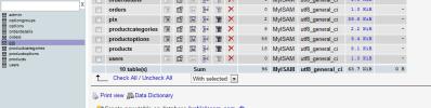

Ok so I believe I got the above question figured out......but now I am stuck on getting the thumb to show in cart. I have uploaded the pic to my MySQL database. How do sync the pic to my products databse? The pics are in a database called pix as you can see in the screenshots below.
the images should not be stored in the database using the blob data type.
In your products table, create a column for the productImage
in that column, store the image file name:
the files should be stored in a folder on your site, for instance:
productImages/myProduct.jpg
the productImage column in the products recordset will return the file name. in your img tag, you can use the data from the recordset:
<img src="productImages/<?php echo $row_RecordsetName['productImage'] ?>" />
