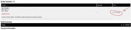

Hi,
I got an email from a customer where he say in the receipt instead of the euro symbol, there is a strange symbol.
I Have Attached Files.
I hope someone can help me.
in the WA_UniversalEmail/WAUE_confirm_1.php file, find the following line:
$WA_MailObject = WAUE_Definition("".($WAGLOBAL_Email_Server)  ."","25","","","","");
and change it to:
[php]
$WA_MailObject = WAUE_Definition("".($WAGLOBAL_Email_Server) ."","25","","","","UTF-8");
[php]
Endrio
thanks,
I'll do a test.
you're welcome.
Endrio
Hi,
I received an order, and now it's ok.
But now it is twice the € symbol.
Take a look the attachment.
send a copy of the WA_UniversalEmail//Email_Templates/receipt.php file so i can examine the code.
Endrio
Hi Jason,
thanks for your help.
in this code:
<td >€ <?php echo WA_eCart_DisplayMoney($WA_Store_Cart, $WA_Store_Cart->DisplayInfo("TotalPrice")); ?></td>
you have hard coded the second euro symbol.
the WA_eCart_DisplayMoney function being used in the echo will pull the currency symbol from the eCart object. using that function will automatically add the currency symbol to the price.
Since you have also hard coded the euro symbol, it will display it twice. you dont need to hard code the currency symbol in that code.
