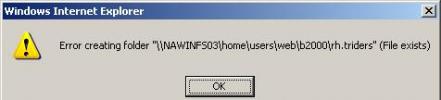

I need Help identifying where to place the folder name for the file uploads, I get an error every time I go to Browse the server.
I created a folder called uploads, in the server to place any files from HTML Editor.
This is the script on the config.php

I have place a copy of the image error.
SHould the folder name be place here ($WA_EditorRemoteRoot = '/uploads/';
Do not edit this in the code.
Go to Insert -> Web Assist -> HTMLEditor -> Site Settings
in the Site Settings dialog box, you will have the option to specify the upload folder.

Once you perform this, how do you "upload" the changes, just upload the html editor folder?
Yes, that is correct, upload the HTML editor folder to the server.
