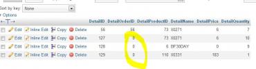

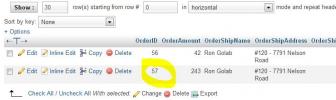

Hi Jason,
As I await your call I have been doing some reviewing and here is where I am at now. I cleared the tables and and reviewed the cart. What is happening now is that the orders are being populated (See Orders_tanle.JPG) and assigned an order ID number. however it looks like the OrderID is simply not being posted to the orderDetails table in the DetailOrderID column (see orderdetails_Table.JPG. Hope this helps get closer to an answer.
