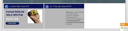

we had to reload a PS3 site (first one ever after many years of success) and also couldn't reload the MySQL database after an unusual errors (screen shot below). We had an older MySQL backup from Dec 20 that works. We could extract the data from the latest SQL export to provide the data to the customer - any clues here would be great?
