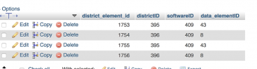

I am trying to do something similar but, for some reason, I am getting the correct number of rows inserted but, as seen in the screenshot, the data isn't correct. It should be:
districtID softwareID data_elementID
395 409 43
395 409 8
396 409 43
396 409 8
Here is my insert code:
