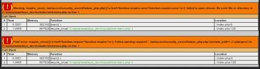

I am also wondering that if I leave this line in within my Server side include ...
<?php require_once( "../webassist/security_assist/helper_php.php" ); ?>
See (error_message-1.jpg)
This line of course in in my source file. But when I remove this line the errors disappear and the page loads properly but in my servers behaviors panel when I am in and editing that include it states "prior version" (see attachment Levels-prior version.jpg) and if I try to update it from here I get the Javascript error (see attachment Java-error.jpg).
