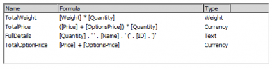

1. PayPal wasnt detecting product option costs so was giving wrong amounts. I did come to a workaround - but not sure if its totally secure until much more testing...Im attaching a screenshot of the work around as after invetigating....
I found that ecart like "TotalPrice ([Price] + [OptionsPrice]) * [Quantity]
But PayPal doesnt like it because it doesnt calculate the OptionsPrice
....However if I changed the above to just [Price] + [OptionsPrice] then PayPal likes it and displays the calculation....but then ecart doesnt like it and doesnt do correct calculation....then I figured to create a new column on ecart object, which you can see from the attached screenshot...I then changed the confirm.php bottom code to:
